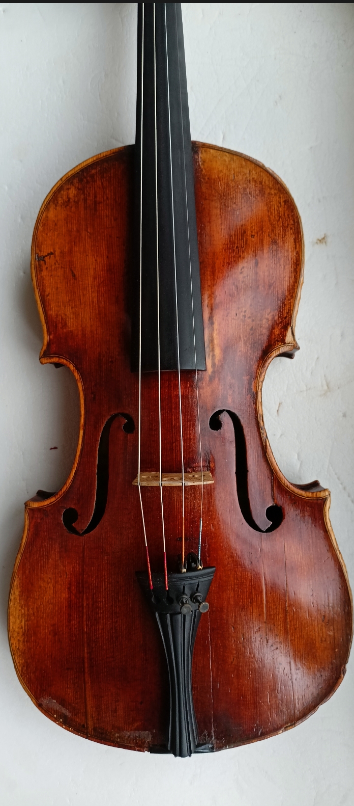

violineroman Posted May 13, 2025 Report Posted May 13, 2025 what are your thoughts on this violin? is it italian?

Don Noon Posted May 14, 2025 Report Posted May 14, 2025 15 hours ago, violineroman said: thanks for the answer. and what level is this "regular" violin? There are more expert evaluators than me, but they don't seem to be jumping in. I'd say that the wood was decent (figured back, ebony? fingerboard, even grain top), construction mediocre-ish, and currently in very rough shape. If I had it, I'd dump it on eBay for whatever it could get. Unless it sounded good, then I'd keep it as a camping fiddle.

violineroman Posted July 23 Author Report Posted July 23 The violin itself looks like this. It's probably a Mittenwald...
Blank face Posted July 23 Report Posted July 23 The dark stripe over the endpin was probably added (rather crude) when the rib was cut and shortened to adjust it to shrinking plates. If it ever was one piece with a notch that featur was destroyed. The body might be a Mittenwald Verleger violin from the mid 19th century, but the scroll seems to be roughly 50 years older, as far as it’s possible to tell this by photos.
