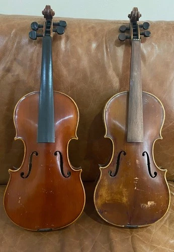

rickpmills Posted October 3 Report Posted October 3 That is a beautiful viola, Marcus!! On the same subject, I think that the violin on the right has a rosewood fingerboard. I say this because I have another violin which has a rosewood fingerboard with the same grain & it is mauvey brown in colour. The grain is very noticeable but it plays well. It's not to everybody's taste but I really like it (see below). I also have two violins with lovely black ebony fb's with brown streaks (both had been painted), anor one with possibly boxwood (I stained it with permanent India ink), & the one shown below which looks like beech (?) - I'll most likely have it replaced in thinned down ebony to match exactly in profile - this really cheap violin has a great tone and volume.
Wood Butcher Posted October 3 Report Posted October 3 I doubt you do have a rosewood fingerboard, that would be fairly unusual. The other one is most likely slab cut maple.

rickpmills Posted October 8 Report Posted October 8 Wood Butcher Members 3.9k Posted Friday at 05:53 PM I doubt you do have a rosewood fingerboard, that would be fairly unusual. The other one is most likely slab cut maple. Slab cut maple. Thanks WB. That's useful. I've done a bit more research - I think you're absolutely right, both fingerboards on the violins shown are not rosewood but probably brown ebony which is apparently not part of the black ebony family but is very dense, hard wearing & pretty attractive in my book. Normally they would be painted over black. The set up violin had been, the luthier who resurfaced it left it as you see it, & the other one has not ever been painted as far as I can tell. But strange because it would have been viewed as being very inferior. Unless it has also been stripped in the past. In any case I am very much looking forward to sanding it smooth & putting a little oil on it to bring out its glory. Anyone else interested in non black ebony fingerboards?
rickpmills Posted October 28 Report Posted October 28 On 10/3/2025 at 5:53 PM, Wood Butcher said: I doubt you do have a rosewood fingerboard, that would be fairly unusual. The other one is most likely slab cut maple. I'm pretty sure it is rosewood you know (another pic. attached). I've been hammering away at ChatCPT from every conceivable angle 'it' seemed pretty certain (wish I'd mentioned to save the threads). Don't know what else it could be. It's not ebony - look at the grain, or a European hardwood. The colour was revealed very recently when the fingerboard was resurfaced by my luthier. It is a mild purple/plum hue, not really brown at all.
