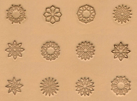

Rico Suave Posted October 17, 2024 Report Posted October 17, 2024 One could get really creative and have a signature pattern using Leather Tooling Stamps
brokenbow Posted October 17, 2024 Report Posted October 17, 2024 My first thought was leather tooling stamps, also, gun makers created a grid like that on the gunstock termed checkering. I guess one could decorate the ends of pegs by inlaying an engraved mother of pearl dot or ?
lvlagneto Posted October 17, 2024 Author Report Posted October 17, 2024 2 hours ago, brokenbow said: My first thought was leather tooling stamps, also, gun makers created a grid like that on the gunstock termed checkering. I guess one could decorate the ends of pegs by inlaying an engraved mother of pearl dot or ? I thought that it might have been some type of hotplate with a pattern, but the file response must be right. I hadn't looked at closer photos to see that the depth of the grooves varied. Some are close to matching in depth, but the direction and depth is not identical on all pegs. When looking at arms length, it looks mechanically clean though. Doing inlay on a peg end or decoration is just another thing to maintain!
