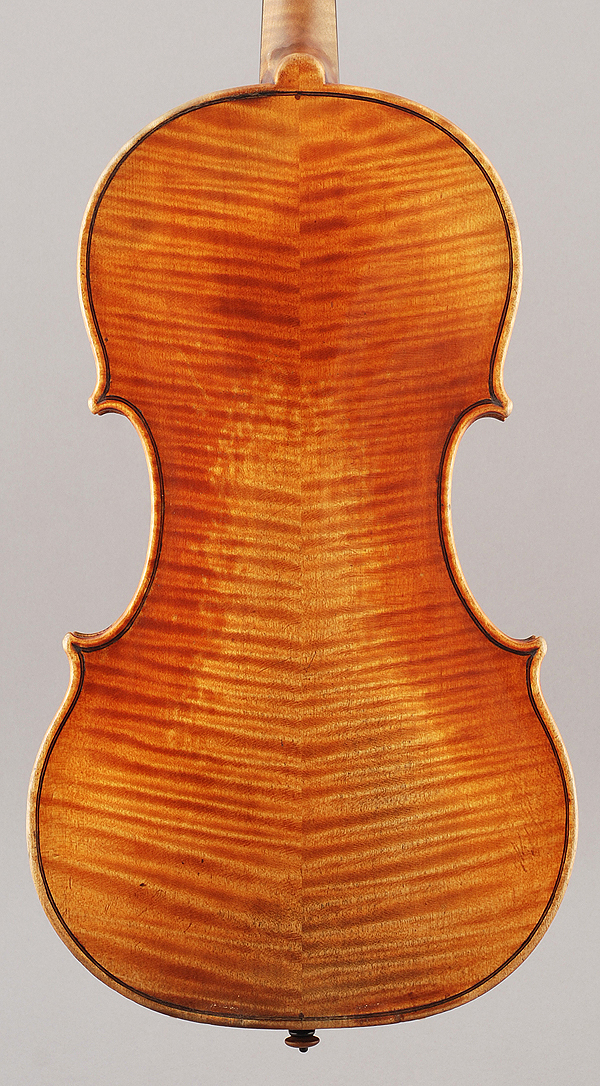

Davide Sora Posted December 19, 2016 Report Posted December 19, 2016 Hi Scoiattola, I use two 1000 W halogen spotlights lamps (with the possibility to switch at 500 W, useful for more "artistic" image) backed wit two white umbrella for indirect lighting to smooth the shadow and minimize the problem of overheating the violin. Nikon D600 digital camera with Nikkor Micro 105 mm lens, a top quality lens with almost no distortion (distortion is an intrinsic characteristic of the lens and definitely a need, problems of perspective on the other hand depend only on the focal length and the distance of the shooting point) 200 mm Micro Nikkor lens would be better for perspective issue and is on my wish (fantastic lens!!) but at the moment too expensive for satisfy a whim (about 1600 euro), whereas the 105 mm works really really well. You might see my set up here in the photo at the bottom of the page. http://davidesora.altervista.org/photogallery/ Never tried other type of lamp, but led and fluorescent may be an interesting option, probably better processed by the white balance of digital camera than halogen and heat less the violin, but I come from analogic photography and I already had those spotlights. Halogen work well but don't last many months and one replacement bulb cost about 30 euro and in the last years the price has grown exponentially (from 16 to 30 euro in only 3 years!!).

Davide Sora Posted December 19, 2016 Report Posted December 19, 2016 Vegas2 162.JPG Macro with a "long lens", what a novel idea!! IMHO, the best light for anything is bright sunlight, and the second best is a reflected xenon strobe. Under studio conditions, using a dedicated macro lens, LED light collars are wonderful for "micro macros". Also, a lot of what you see depends on the filters used. As Martin implied, photos can lie, and can do so even when it is not the illustrator's intention. There are some things (I could be specific, but it would hijack the thread) which look entirely different (in terms of color, surface roughness, patterns seen on the surface, etc.) from what one sees ordinarily, depending on how the object is illuminated, and can only be properly appreciated/imterpreted from a series of photos taken under various lighting conditions (particularly with regard to angle and intensity). Very nice shot Violadamore. Macro lenses are good for details like corners, purfling mitres and so on, but the main reason why I use them for everything else is the minimum focusing distance, which almost always in normal lens is too long for violin photography. I have a "normal" 200 mm that has a minimum focusing distance at 1.6 meters, too much for a scroll shot. Another reason is the sharpness and the micro detail reproduction abilities (such as wood grain) that a good macro lens expressly designed for reproduction should have (the Nikon lenses I mentioned are perfect in this respect, but for example too sharp for classic portrait). I make the canonical and "flat" pictures (for which I need a set up of symmetrical and balanced lights) for my archive and for certificates of authenticity. These allow an indisputable certainty for the identification of instruments against faking, because wood grains are like fingerprints and in this case good quality photos do not lie at all. For more artistic photos actually you do not need too much sophisticated lights, but thanks to digital technology offering countless trials and corrections even a couple of desk lamps can be also fine if the photographer is good and equipped with fantasy. But in these cases, photos can lying and be very deceptive.....
