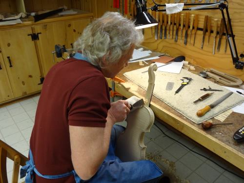

David Burgess Posted June 4, 2014 Report Posted June 4, 2014 This may offend Roger (at least I hope so ) but you'll notice in the background that my gouges are stuck to a velcro strip. Quicker to grab and replace than some kind of rack. Heck, if I'd thought of it, I could have covered more of the wall with velcro and glued the other part of the velcro all the way around the handle. Then I could just fling the gouges at the wall and have them stick.

David Burgess Posted June 4, 2014 Report Posted June 4, 2014 I'm a bit embarrassed to show this, because I think bending ribs is easy enough anyway, You must have been emboldened by the realization that it's impossible to put up anything sissier than Velcro tool hangers.
