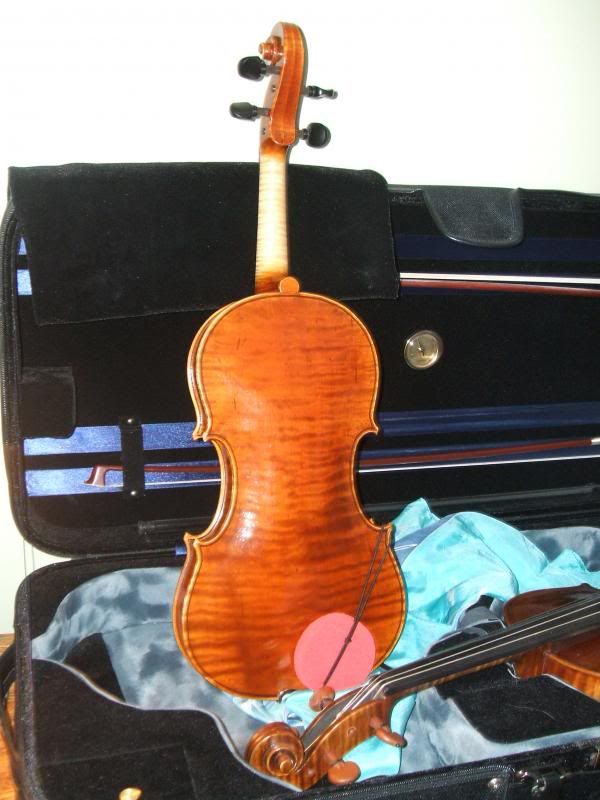

miles Posted June 12, 2013 Author Report Posted June 12, 2013 Yes. Miles, Have you thought about the quality and shape of the chin rest? The typical small, low, plastic, mounted on the left chin rests for fractional sized violins can be rather non-functional. It might be worth spending some time experimenting with chin rests to see what works best, and then a very simple sponge and rubber band arrangement as a shoulder rest might work fine, if any shoulder rest is needed at all. Hello skiiingfidder, Nice to hear from you! Thank you very much for the suggestion. I had a few things in mind in regard to the chin rest: (1) soft adjustable chin rest, which I saw on eBay (could not find it anywhere else?) and looks appealing from the photo: http://www.ebay.com/itm/ADJUSTABLE-VIOLIN-CHIN-REST-1-8-1-4-1-2-SOFT-NEW-/140356340550?pt=String_Instrument_Parts_Accessories&hash=item20ade3cb46 or (2) regular ebony guar. style chinrest one of these will be covered with chinrest pad or gel I am not sure whether it will work, but I really like the idea to cover the whole chinrest because mine hurts chin and neck. Many thanks also to Robertdo and Rue. Rue's violin is very beautiful, and the sponge looks like dust pad for make-up? I will actually try it on my violin, too.
Rue Posted June 12, 2013 Report Posted June 12, 2013 Why thank you! I tried all kinds of sponges and find these red ones the best. I got mine from Shar. I also use the covered hair elactics to hold it on with. They are 'softer' than a rubber elastic. I just strung two together for length. Ask your daughter's teacher what her aproach to shoulder rests is. Some individuals need them and others play best without.

Rue Posted June 12, 2013 Report Posted June 12, 2013 I'd be too paranoid to glue something on my violin too... The hair elastic works well...and I don't bother to take it off most of the time. It doesn't hinder storage in the case. And it really doesn't move very much. I sometimes tug it downwards a bit so my collarbone (the reason for the pad in the first place) is fully protected from bruising...but that's about it. But the red cosmetic sponge from Shar is by far the best...it is soft, has a nice density, doesn't move and is lasting really well. I also like that it's red...it doesn't 'stand out' like the white ones do.
Violadamore Posted June 12, 2013 Report Posted June 12, 2013 That isn't paranoia, it's good solid common sense. It rather amazes me, the liberties some folks take with valuable classics that they either own or have on loan. I've seen examples on videos, and occasionally in person, and heard about more, that are stunts I wouldn't pull with one of my better Germans, much less a Strad or GDG. Of course, if I sat on one of mine, or smashed it into a music stand, or tripped on my skirt and fell on it while dancing, or whatnot, guess who'd have to fix it again . Rue, those violins are absolutely beautiful
Rue Posted June 12, 2013 Report Posted June 12, 2013 Why thank you too! The darker one in the case - with the black-painted pegbox (that I don't personally like the look of) ...is my viola. I love the way it sounds as well as how it looks (er, outside of the pegbox, did I mention the pegbox?)!
