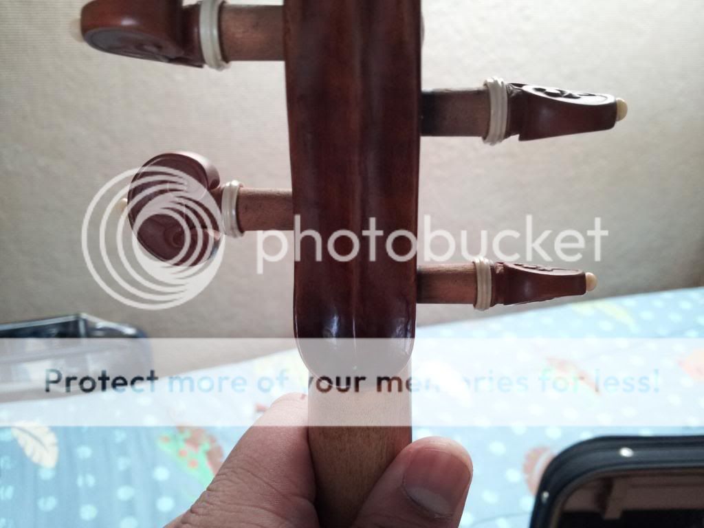

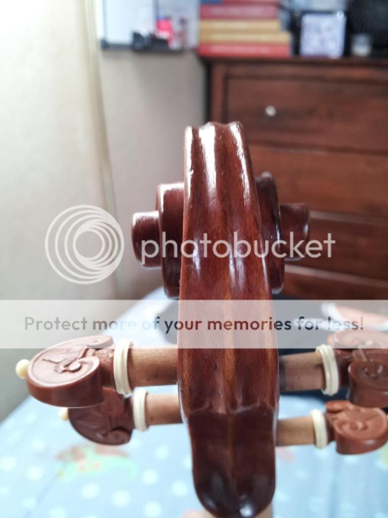

jacobsaunders Posted May 5, 2013 Report Posted May 5, 2013 Many years ago I had a violin stamped Chappuy with such ebony edges. At the time I visited the museum in Mirecourt, where I was surprised to see other ebony edged violins (stamped Lupot, if I remember rightly). I cannot remember ever seeing this feature from Markneukirchen area instruments, although I have an old violin by Heberlein with similar edges in ivory (and have seen others). Both the Chappuy and the Heberlein also have ebony resp. ivory edges all around the pegbox & scroll,which would lead me to want to critically investigate if your fiddle hasn’t got a later replacement scroll. I also wonder if your violin isn’t slightly later than the Chappuy but think you should find an expert with a main emphasis on old french fiddles (which would rule me out)

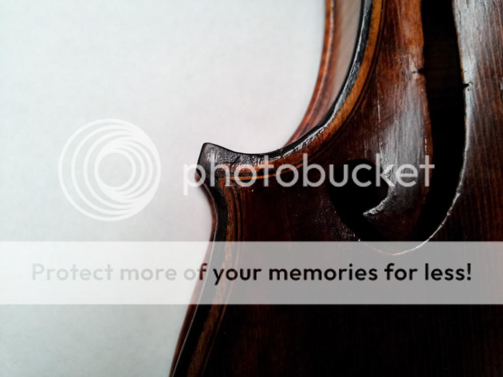

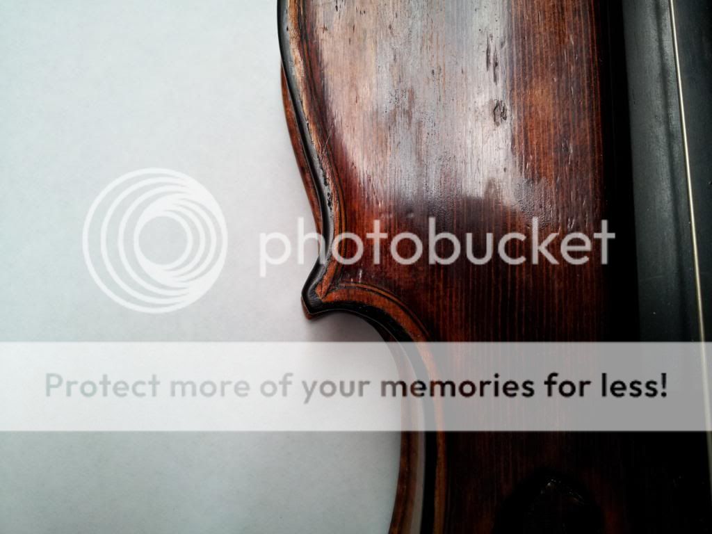

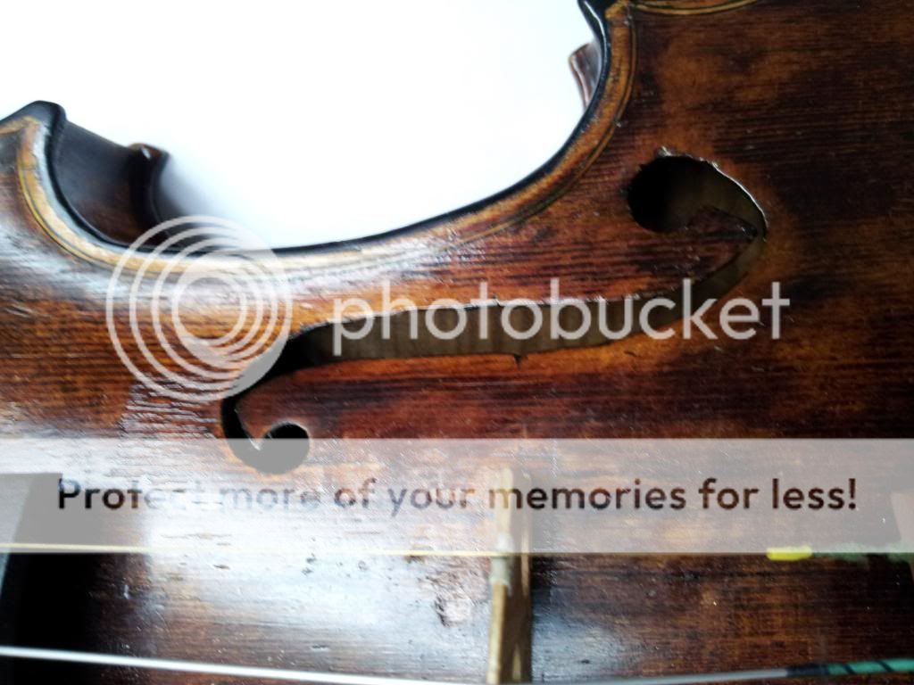

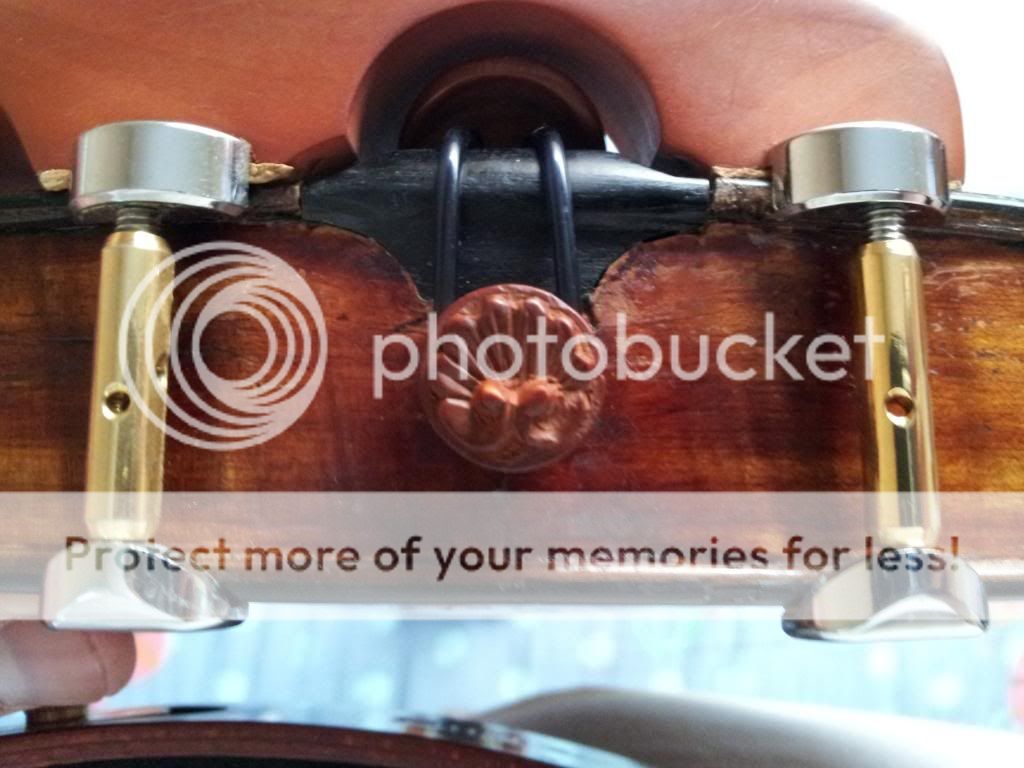

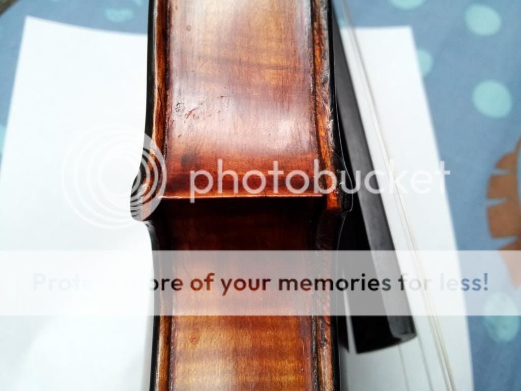

hendrik Posted May 7, 2013 Report Posted May 7, 2013 More pictures please: details of the purfling particularly near the bee stings; where the ribs come together , also how they connect to the back soundholes up close back of scroll endpin area c -bouts
vio.lino Posted May 7, 2013 Author Report Posted May 7, 2013 Bee Sting Photos: Ribs: F-Holes: Scroll: Endpin:
Ben Hebbert Posted May 8, 2013 Report Posted May 8, 2013 I'll be really clear (and destroy your hopes), Guidantus is a relatively well known maker with a distinctive style. This isn't remotely close to his work. I don't know what this is. I have never seen ebony like that before. It could be something out towards Hungary, but it certainly doesn't strike me as French. -sorry! Ficker and similar are always quite beautifully done when they have ivory edges!
vio.lino Posted May 8, 2013 Author Report Posted May 8, 2013 Haha, it didn't destroy my hopes. The more I look at this, the more Guarneri-ish it looks. My director has given me more information that it is from a professor in Europe about 15 years ago. Any other thoughts?
hendrik Posted May 8, 2013 Report Posted May 8, 2013 The 1737 Guidantus at the Banff Centre instrument bank has been appraised and insured for 100,000.= Canadian dollars. The instrument you are showing was appraised at about 1/4 of that price. What was the appraisal based on? You mention a certificate. Could you show it? It might say "an instrument labeled Guidanus.." which would mean nothing at all. Now it is being sold for 7500 dollar. Again why? Was the initial appraisal totally off or did the instrument need some extensive repairs? You mention revarnishing: how extensive was it? Usually some alarm bells are starting to go off in my head when hearing these kind of stories. Particularly without any clear reason why these numbers. But maybe there is a good explanation. It is an interesting looking violin. Is the black lining really ebony? Or only a part of it is? It looks so seamless in many places.

jacobsaunders Posted May 8, 2013 Report Posted May 8, 2013 My main concern is if this violin is a cottage factory instrument. I hope you won’t mind me pointing out that “cottage factory (instrument)” is a perfect oxymoron. Having now just looked at the second lot of photos you posted, which I hadn’t noticed before, I can’t help seeing several Vogtland/Egerland features, such as the beveled of f wings or (it seems) the lightly beveled off rib corner. Just because I have never seen one from there with ebony edges, doesn’t mean there can’t be any. I still think the scroll is later, I’m afraid.
