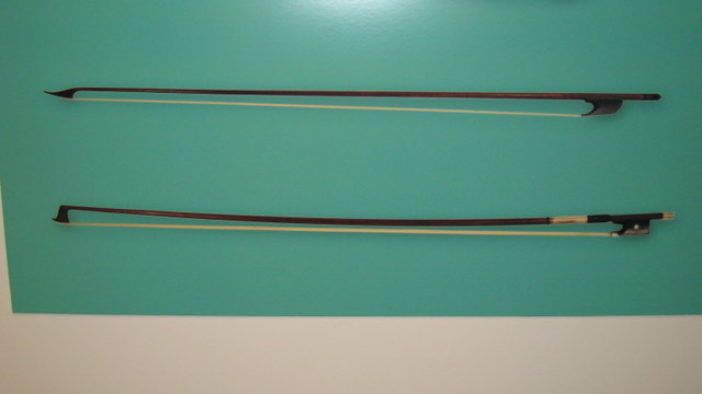

Chris Knowlton Posted April 12, 2008 Report Posted April 12, 2008 For those readers who might like a picture, here is a typical baroque (top) and modern bow (bottom).
Andres Sender Posted April 12, 2008 Report Posted April 12, 2008 Well, the top bow is a good illustration of what the Chinese call 'baroque', it's more an approximation than an illustration.
Chris Knowlton Posted April 13, 2008 Report Posted April 13, 2008 Hi Andres, I took the above picture while visiting the Stearns colletion at U of M. The top bow was labled "European Baroque". I assumed that they were correct but I should have researched it more before posting. Do you have a picture of a more typical baroque bow? Thanks.
Andres Sender Posted April 13, 2008 Report Posted April 13, 2008 The above-mentioned article has some good photos. I'd love to know more about the Stearns bow, it looks like a transitional bow to me. Knowledge about early bows is rather in flux these days. The recent article by Dr. Seletsky in the Early Music journal challenged a number of ideas which have been widespread due to strongly influential publications by David Boyden (most notably the book The History of Violin Playing from Its Origins to 1761). In December of last year, Early Music Review (a publication of King's Music in the UK) published a very interesting and well argued critique of some of Dr. Seletsky's conclusions by Dr. Kevin MacDonald, and now Dr. Seletsky has an article in the same publication in February of this year which I have yet to read. I'd love to hear what Dr. MacDonald thinks about the Stearns bow, perhaps I am too hard on it.
Guy_Gallo Posted April 13, 2008 Report Posted April 13, 2008 Andres, are you saying that the top bow in this picture strikes you as "transitional?" If so, in what way? From what? What would make a bow more baroque? It certainly fits what I've been assuming was a baroque bow, what I've seen period performers (like Fabio Biondi and Andre Manze) using when they played on period instruments.
Guy_Gallo Posted April 13, 2008 Report Posted April 13, 2008 After reading Stephen Marvin's article I think I understand. Baroque Pattern: shorter, lighter, clip in frog. Long Baroque Pattern: longer overall, shorter swan head, screw frog. He says: "A typical baroque bow before 1730 was a very short, light stick with a clip-in frog. Later long baroque bows similarly would not have screw adjusters or significant concave cambre before 1750 or 1760 in France..." So this is transitional because it is longer? I can't tell from the picture if this is clip in frog. But it looks like it might be.
Andres Sender Posted April 13, 2008 Report Posted April 13, 2008 I don't know that one can rely on the length in this to do much more than say "probably later than 1730". This is how I'm thinking about this stuff currently. The term 'transitional' refers to bows which show some evolution from the usual designs of the baroque period, but which do not yet show the full set of features associated with the classical bow. Since there is evidence that bows of a superficially baroque style were still being made during the latter half of the 18th century, 'transitional' is not just a matter of gross type. 'Swan head' bows may be baroque or they may have been made during the transitional period. Although Boyden would have us believe that screw frogs appeared as early as 1700, even MacDonald puts the date forward to 1730 or so, which means that a screw mechanism bow with baroque features is at least a very late baroque bow, and likely a transitional bow. Because of this one is left to look at subtler stylistic issues in dating bows. The Stearns bow shows what appears to be a well-developed screw frog (it seems to envelope the stick a bit), and a rather high head which leans towards the 'Cramer' in style, i.e. in how the face extends slightly under the throat. In all it just fits better with the neo-baroque transitional bows for me than with the unequivocally dated baroque bows. I'd like to know the provenance of the bow, and what kind of mortises it has.
Guy_Gallo Posted April 13, 2008 Report Posted April 13, 2008 I'm not seeing "leans toward the 'Cramer' in style" in the top bow. Looks like a pretty normal swan-head. Isn't this Cramer style: Or did you mean the bottom bow is tending toward the Cramer.
Andres Sender Posted April 14, 2008 Report Posted April 14, 2008 I was talking about the top bow. The way in which the top bow differs from the modified version below in this crude illustration is what I mean. Even the edited version looks later to me. To my eye the Stearns bow is headed away from the early swan head style and towards this sort of esthetic (shamelessly nabbed from Ralph Ashmead's site, don't know the date of the original): ...and actually the Stearns swan-head bow has much in common with the "French baroque-pattern" transitional bow head illustrated in the Marvin article.
Guy_Gallo Posted April 14, 2008 Report Posted April 14, 2008 Yes, I can see that the neck has a very slight turn in. And yes, I see it's similarity with what are called transitional. But it is still clearly a) not a Cramer head and closer to the baroque type than to the classical. Perhaps the problem -- which is well illustrated both in Marvin's paper and other writers on bow development -- is that ALL bows from the 18th century, to one degree are another -- were "transitional" -- that is, there were myriad variations. There is no one type of "transitional." So in that broad sense, okay, the stearns bow is not the purest Baroque bow, clearly not a modern -- so it's transitional. I find the term has very little meaning when applied to 70 years or so of experimentation. It seems to me it only has meaning when applied to an experiment -- like the Cramer head or the battle-axe head -- that was clearly pointing to a style that persisted -- the modern Tourte. Or the truncated swan-head (your second illustration from Ashmead) that looks to me to foreshadow Persoit and Pageot. The operative qualities of what is commonly called a Baroque bow (accepting Marvin's caveat that most re-creations are of later long baroque style) are: 1) lighter, 2) less tension due to the lack of camber, 3) thinner ribbon 4) the ribbon gets closer to the stick as it approaches the tip (rather than held equidistant from the stick by a down/in turned head).
