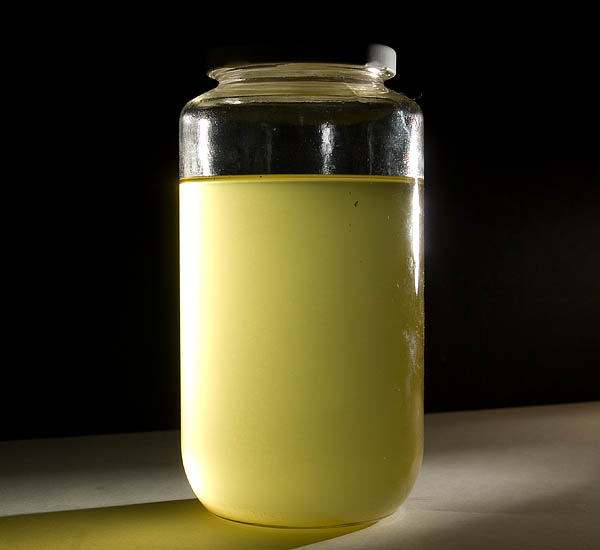

Seth_Leigh Posted May 13, 2007 Author Report Posted May 13, 2007 I've had a couple of offline requests by people not to stop posting pictures until this stuff is completely done, so here goes. This morning I poured the mastic syrup into another jar, and added 100 grams of washed linseed oil. Here's a picture showing what it looked like after I poured the oil into the mastic, but hadn't shaken it up yet. The second picture is the same stuff after I shook it vigorously for a minute or so and then let it settle for a couple of hours. This haze will slowly sink to the bottom of the jar, leaving just crystal clear varnish. I'll get some photos as it starts to settle.
Seth_Leigh Posted May 14, 2007 Author Report Posted May 14, 2007 Btw, it's been 9 hours or so since I mixed the oil in, and there's already a layer maybe .5mm thick at the top that is clearing, and the haze is already starting to settle. I bet it will be enough to photograph it in the morning.

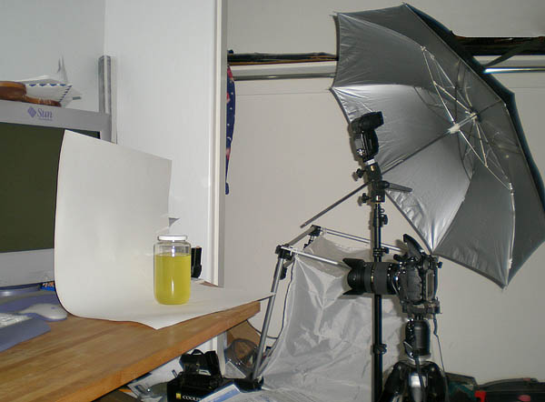

Seth_Leigh Posted May 15, 2007 Author Report Posted May 15, 2007 I decided to geek out and have some fun with this. I'd actually dreamed about doing this very thing for quite some time now, if that tells you anything about me. I set my camera up with an off-camera flash shooting into an umbrella. I put the jar of varnish on a sheet of posterboard to act as a white background. My camera has a built-in timer functionality, and I was able to set it to take a photo every 15 minutes. I'm going to let the varnish just sit there and clarify, and let my camera just automatically snap a shot every 15 minutes for a few days, or a week or two at most, if that's how long it takes for the varnish to clarify. My flash, at the power setting I used, can last for days on one charge of the batteries, and I have another spare set ready to go. My camera can also go for days this way, plus I have an extra camera battery and memory cards. In the end, when the varnish has clarified, I intend to batch-process the images into some low resolution and combine them with whatever tool can do this into a Quicktime or other movie format. I hope to be able to view this whole clarification in like 30 seconds at 30 frames per second or something like that. Anyhow, I'll let this run and in the end, if it looks interesting enough, I'll post a link so people can see it themselves. Even if it's not interesting to look at in the end, it'll have been interesting for me personally to figure out this timer functionality on my camera and learn how to do a movie this way to capture a long process over time. Here's a shot showing the simple setup. I took it with my daughter's inexpensive point and shoot camera.

Seth_Leigh Posted May 15, 2007 Author Report Posted May 15, 2007 Actually the remote flash is just a normal Nikon flash. The silver umbrella in this picture cost $19. Add in the $15 bracket to hold the umbrella and flash, and an inexpensive stand to mount it on (can use a cheapo tripod if you want) and going off-camera like this really doesn't cost much. I already had the flash when I got my D200, so beyond that, even buying the stand shown in the picture specifically to hold the umbrella and flash, my off-camera setup cost me under $100. At the most basic, a person with a D70, D80, or D200 and a Nikon SB-800 or SB-600 flash can go off-camera just by going into Commander mode with the camera's onboard flash, setting the SB-600 or SB-800 to Remote mode, and setting it on a chair, pointed at the ceiling or bouncing off a piece of posterboard or something. I've taken off-camera flash photos before just by having my daughter or someone else hold the flash pointed at what I wanted, while I held the camera and took the photo. Nikon makes it so easy.

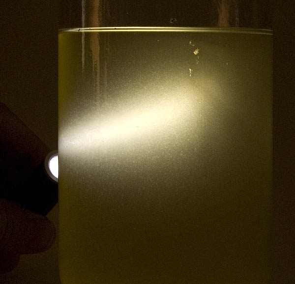

Seth_Leigh Posted May 15, 2007 Author Report Posted May 15, 2007 Here is a pic I took shining a small LED flashlight through the back of the jar. I did this because the other photos weren't showing what's been happening in the last day. By tonight the very fine haze particles are clumping together into larger clumps. Eventually all this haze will have settled to the bottom of the jar. I changed my off-camera flash setup. I put up a piece of dark posterboard behind the jar, and rigged a simple cardboard snoot (a little tube to limit the light cone coming from the flash and make it very directional) onto the business end of the flash, and set it up to come in from the back somewhat, in an attempt to be able to show the same kind of effect that I have with this flash light shot. So in my eventual little movie of the clarification process, the first second or two will be with the umbrella, and the rest of it will suddenly change to a different lighting setup. Oh well.

Seth_Leigh Posted May 15, 2007 Author Report Posted May 15, 2007 Thanks for the comments Berl! Here's another one. This shows the clarification about 52 hours since I mixed the linseed oil into the mastic syrup. I should remark that this is clarifying a bit differently than I remember my previous batches doing it in 2004. Back then there was actually a dropping of the haze to the bottom of the jar that left a clear, and growing, layer of pure varnish as it decended to the bottom over a number of days. This time around the haze particles are coalescing into larger clumps, sort of like wet snow for those of you who live in appropriate climates. You can see a growing layer of sediment at the bottom of the jar as this stuff slowly settles out. You can in fact see a very thin clear layer just below the surface, but it doesn't seem to be growing the same way that I remember. I guess the next day or two will probably show how this is going to progress. At any rate, this varnish will be crystal clear before it's considered done. And I don't have to do anything to it at all except let it sit and let nature take its course.

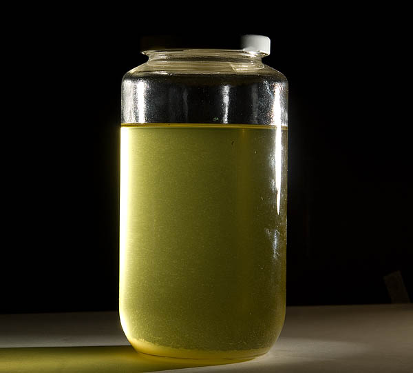

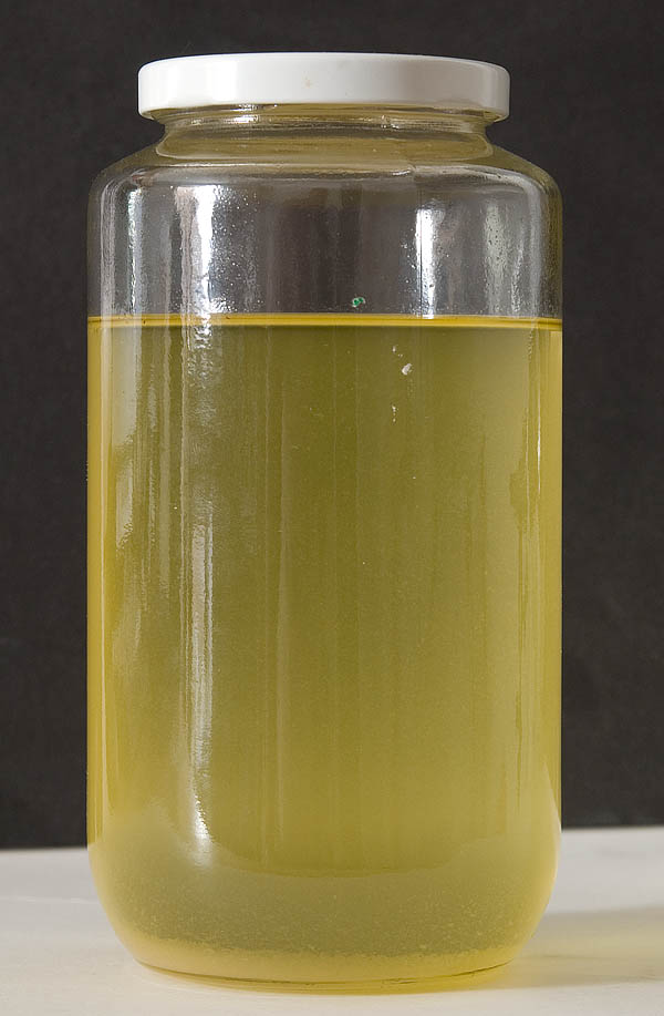

Seth_Leigh Posted May 17, 2007 Author Report Posted May 17, 2007 Ok. Here are two pics of the varnish as its clarifies. I mentioned previously that I changed the photo setup from using an umbrella with my flash, to using a snoot with the flash instead, and changed from a white background to a black background. I did this because I felt it would help improve the contrast between the haze and the background and thus make it more obvious as it it clarifies. So, here's a picture of the varnish as it was on Tuesday, with the current lighting setup. Note that on Tuesday it had already been clarifying for two days. And here's a picture from today. You can see that it's already clarified significantly over what it was just two days ago. There's still a lot of haze in there, and it's not crystal clear yet by a long shot. Also, the haze seems to be just nearly evenly disappearing, whereas varnish I made in 2004 actually saw a haze level drop with a distinct line where it went from hazy to crystal clear, and the line went down slowly and evenly over time. This time that's not happening - the haze is just settling out slowly and the stuff is becoming more clear over time.
