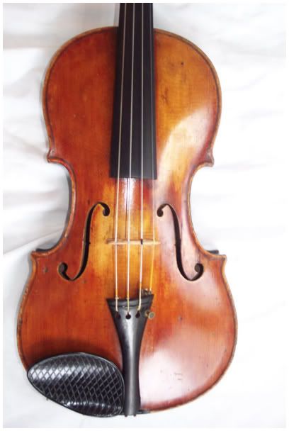

Here's the fiddle before given to a luthier to clean and restore. The varnish had been worn nearly off in two spots.
Did he say what on earth is Viennese about the back?
Nope. Realize this was not a certificate appraisal, but a verbal assessment if such a cert was even possible. I think he was more interested in the other violin I had with me (a Voller) for which he did write a cert.
Still, that was his suggestion suggestion. I'm open to others. What's it look like to you?
The violin in this gallery has been deemed a composite by Beare. 18th c Viennese back and 19thc Italian front was his guess. No maker suggested for either.
